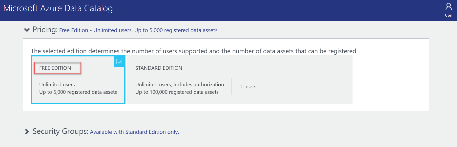

Scroll a little down to select the Pricing, this service is offered in two editions. For this demo, I am selecting the FREE EDITION.
向下滚动以选择Pricing ,此服务提供两个版本。 对于此演示,我选择 免费版。

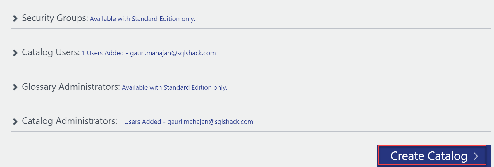

I am keeping everything as default for the below categories, your ID is automatically added as a catalog user and an administrator. You can further add catalog users and catalog administrators to the catalog. And finally, click Create Catalog to create a Data Catalog named, OurSalesData in Azure.
我将以下类别的所有内容保留为默认值,您的ID将自动添加为目录用户和管理员。 您可以进一步将目录用户和目录管理员添加到目录中。 最后,单击“ 创建目录”以在Azure中创建一个名为OurSalesData的数据目录。

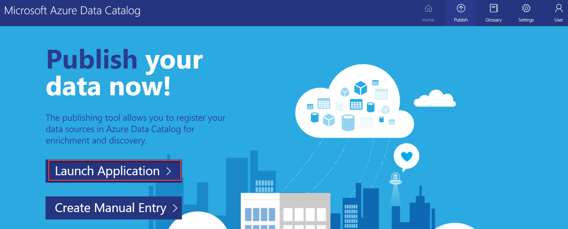

There are two options with which you can register or publish your data sources in the Data Catalog, – Launch Application and Create Manual Entry. I personally do not prefer the “Create Manual Entry” option, as it would be a challenging and time-consuming activity for larger data sources. It is better to go with the “Launch Application” option as it is just a click-once application.
您可以使用两个选项在“数据目录”中注册或发布数据源:“启动应用程序”和“创建手动输入”。 我个人不喜欢“创建手动输入”选项,因为对于较大的数据源而言,这将是一项艰巨而耗时的活动。 最好使用“启动应用程序”选项,因为它只是一个单击一次的应用程序。

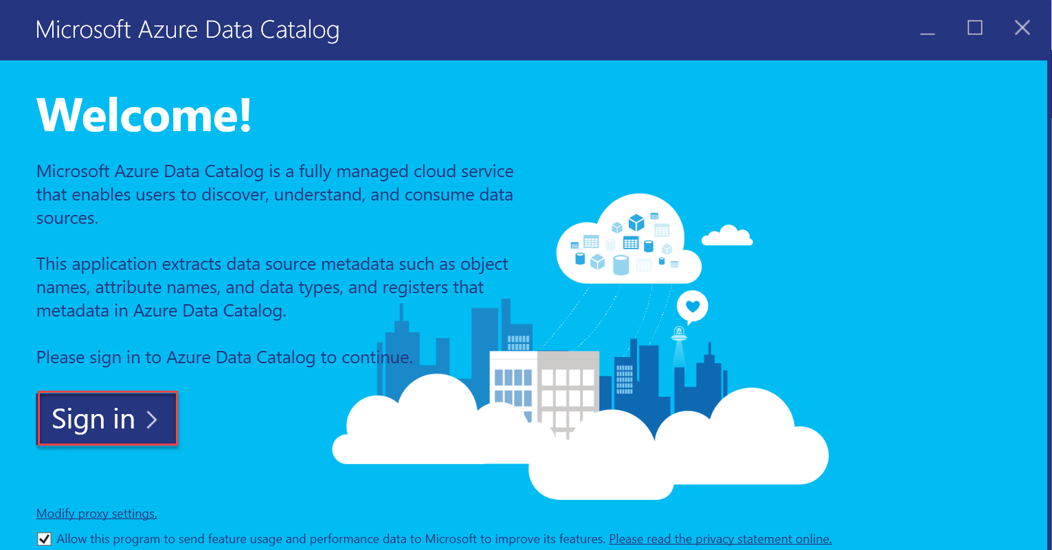

Once, this application is successfully installed, you are brought in to the Sign in page. Sign-in using the same credentials that you used to access the catalog in the portal.
成功安装此应用程序后,您将进入“ 登录”页面。 使用与访问门户中的目录相同的凭据登录。

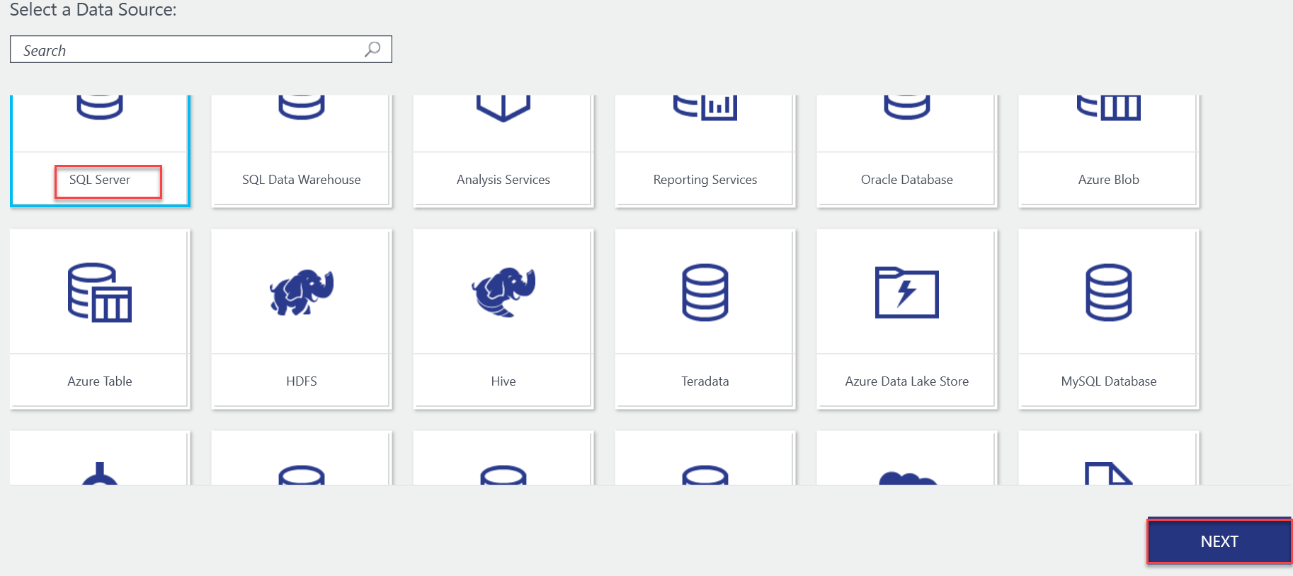

You can register tons of data sources like SQL Server, Reporting Services, HDFS, Hive, HANA database, Azure Data Lake Analytics etc. as shown below in the Data Catalog. Since I already have a SQL database in my account, I will go with SQL Server as the data source. Click on SQL Server and select NEXT.
您可以注册大量数据源,例如SQL Server,Reporting Services,HDFS,Hive,HANA数据库,Azure Data Lake Analytics等,如下数据目录中所示。 由于我的帐户中已经有一个SQL数据库,因此我将选择SQL Server作为数据源。 单击SQL Server并选择NEXT

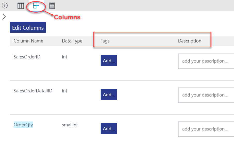

We can also add meaningful descriptions and tags to all the columns present in the table in the Columns tab. This will not only help us know where the attribute is located but also depicts what this data attribute is all about.
我们还可以向“ 列”选项卡中表中存在的所有列添加有意义的描述和标记。 这不仅可以帮助我们知道属性的位置,还可以描述此数据属性的全部含义。
